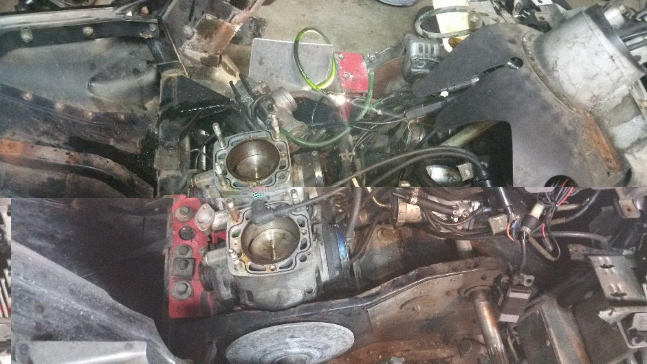

Well clutch puller is on its way so I tore down more preparing to remove engine.
I did have a question come up. How do I remove whole track from bottom of tunnel. The manual I have does not explain the process. I removed the drive chain. Didn't know if I should flip sled on side or jack up.
Any advice is appreciated.

Re: 87 Vmax Project
On the side is the best way and B.T.W. heat, let cool, tap with a hammer and soak with penetrating fluid is the only way to loosen the 3mm set screws in the shaft.
