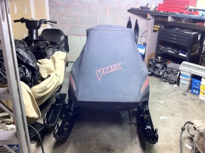

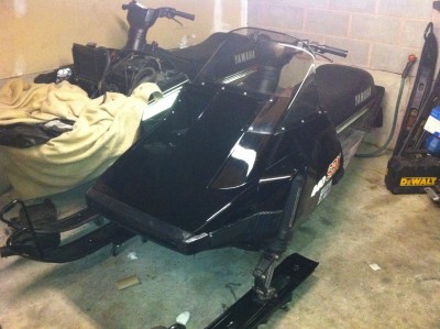

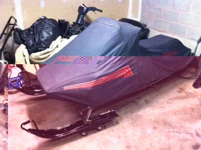

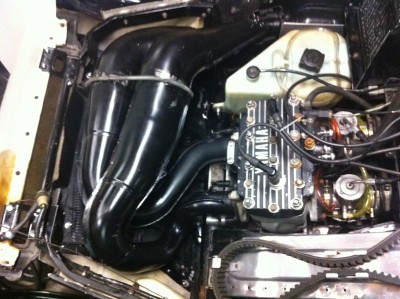

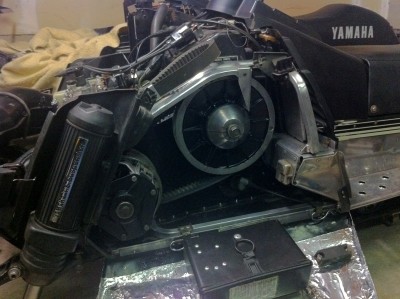

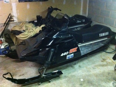

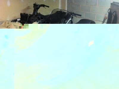

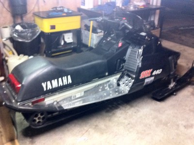

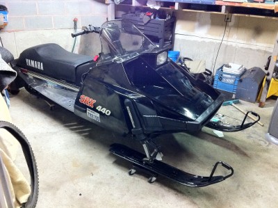

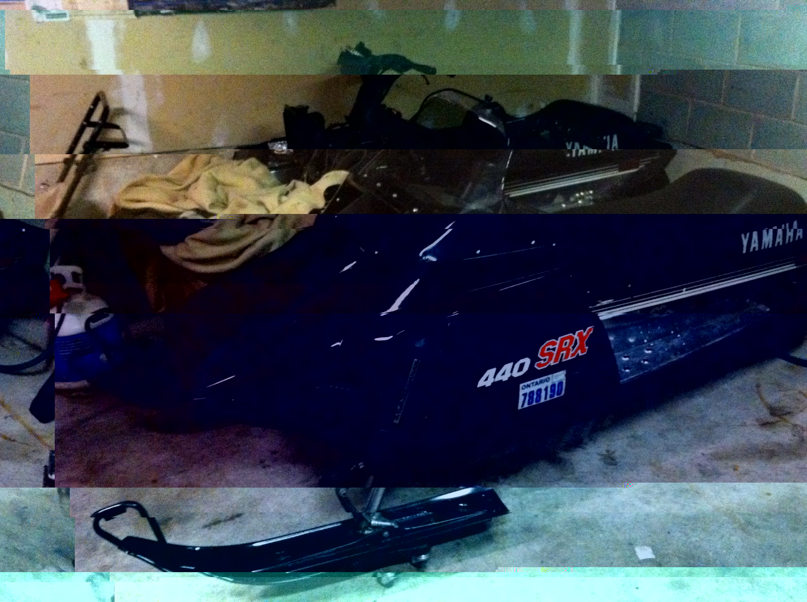

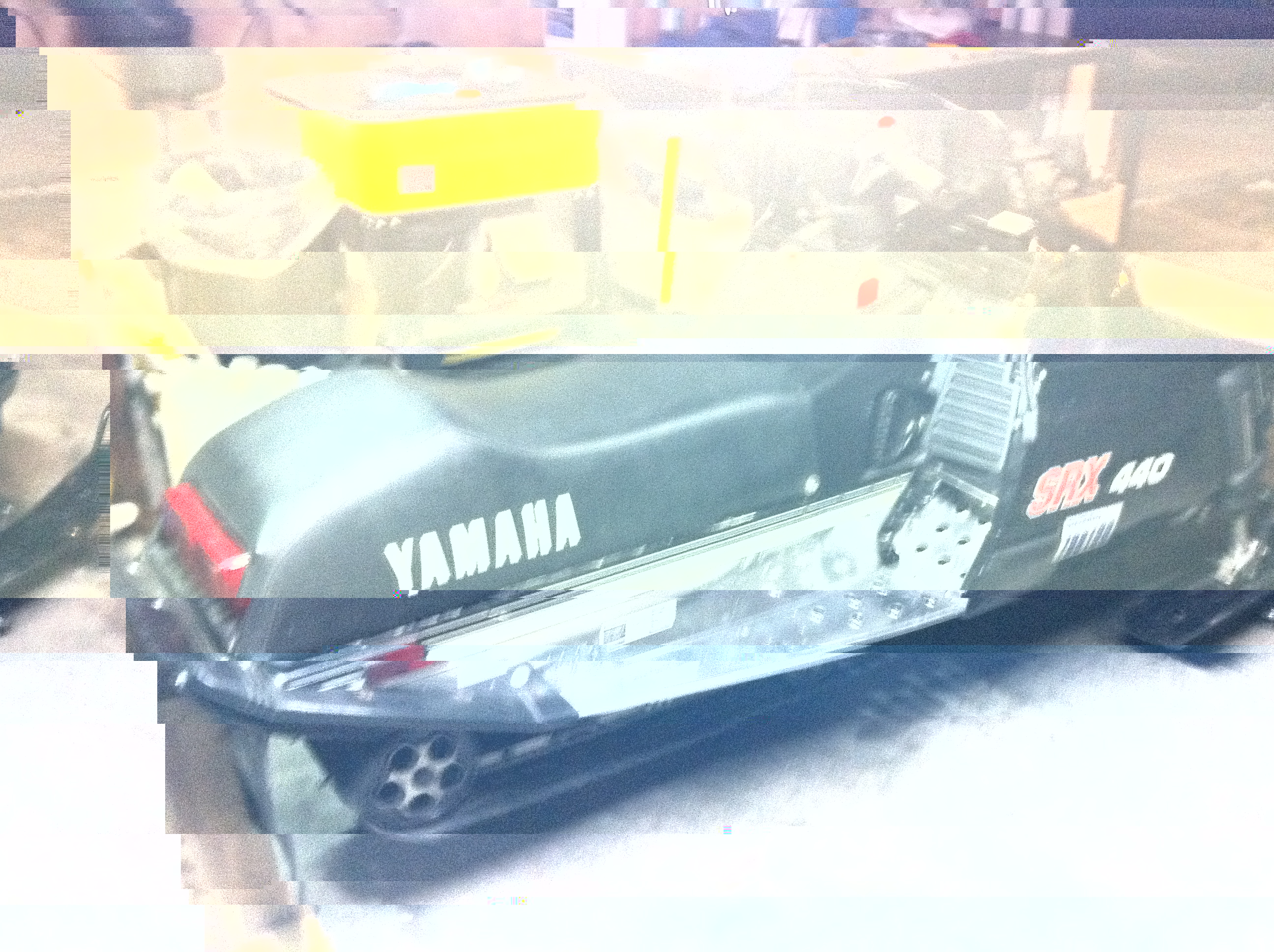

here are some pics of one of my srx that i have just finished rebuilding.

Looks great! Love the looks of those SRX's. Nice work! Vector Boy

VectorBoy wrote:Looks great! Love the looks of those SRX's. Nice work! Vector Boy
thank you vector
Re: MY 81 SRX 440

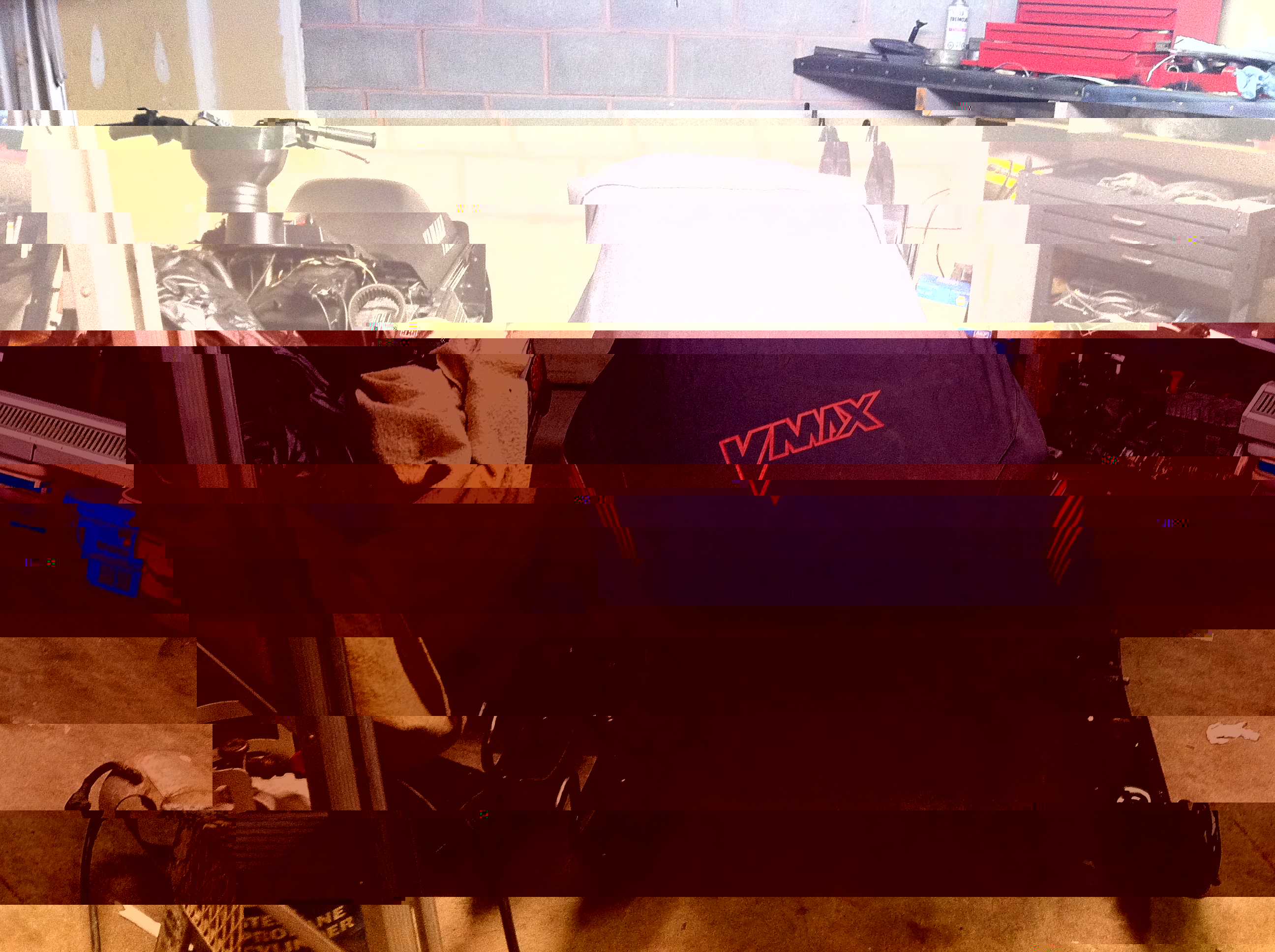

Awesome.... and there is another in the corner ! :)

thanks and yes the one in the corner is being done next I just sent out my cylinders to CVTech to get re Nikasil now i am just waiting for them to be done then gonna start building the 540 motor for it but i need to now what rings to use for the nikasil i got alot of chrome bore rings but i was told to use cast iron rings what would happen if i used the chrome bore ring? would i wrecked the cylinders?
