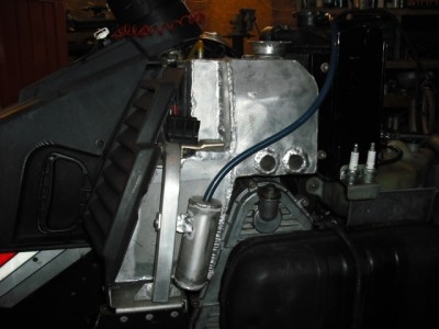

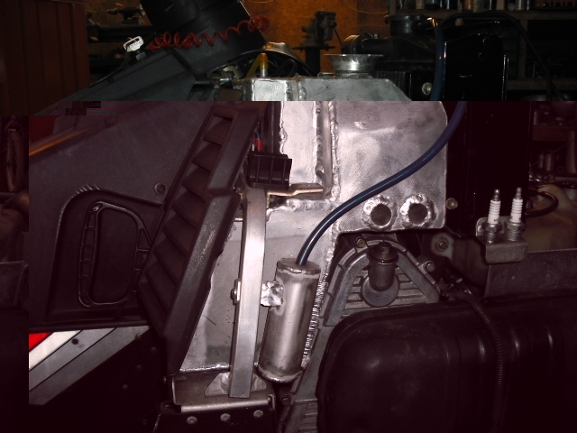

6. Made an additional gas tank (see photo, yes it took a lot of time and no I don't want to make another)
All of these items I have found on this site or from VMax540. Was out last night on the VMax and it is just awsome. I am now getting in the teens for gas milage. I love this site.

Thanks Kyle ! Here is a picture of the air box panel and the line to be cut out. B.T.W. some of the old Enticers had a black tank very simular in shape to your spare tank now, if I can just find one for reference and size.
