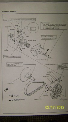

Yamaha's service manual of which I have several different years do not show lock tight for the spider and shows 173Nm or 12.5 ft.lb. Comet shows to use lock tight and tighten the spider to 250 ft. lbs ! Personally, I have never seen a clutch unscrew itself from the fixed sheave and can't imagine using 250 ft.lbs. What sould torque setting be set and would you use lock tite ? I'm half tempted to use never seize.

Thanks, I did not catch that, there must be an error in Yamaha's manuals ? Still 127 ft. Lbs is half of Comets 250 ft Lb recommendation ?

must be because the conversion site has no m-kg listed only nM
