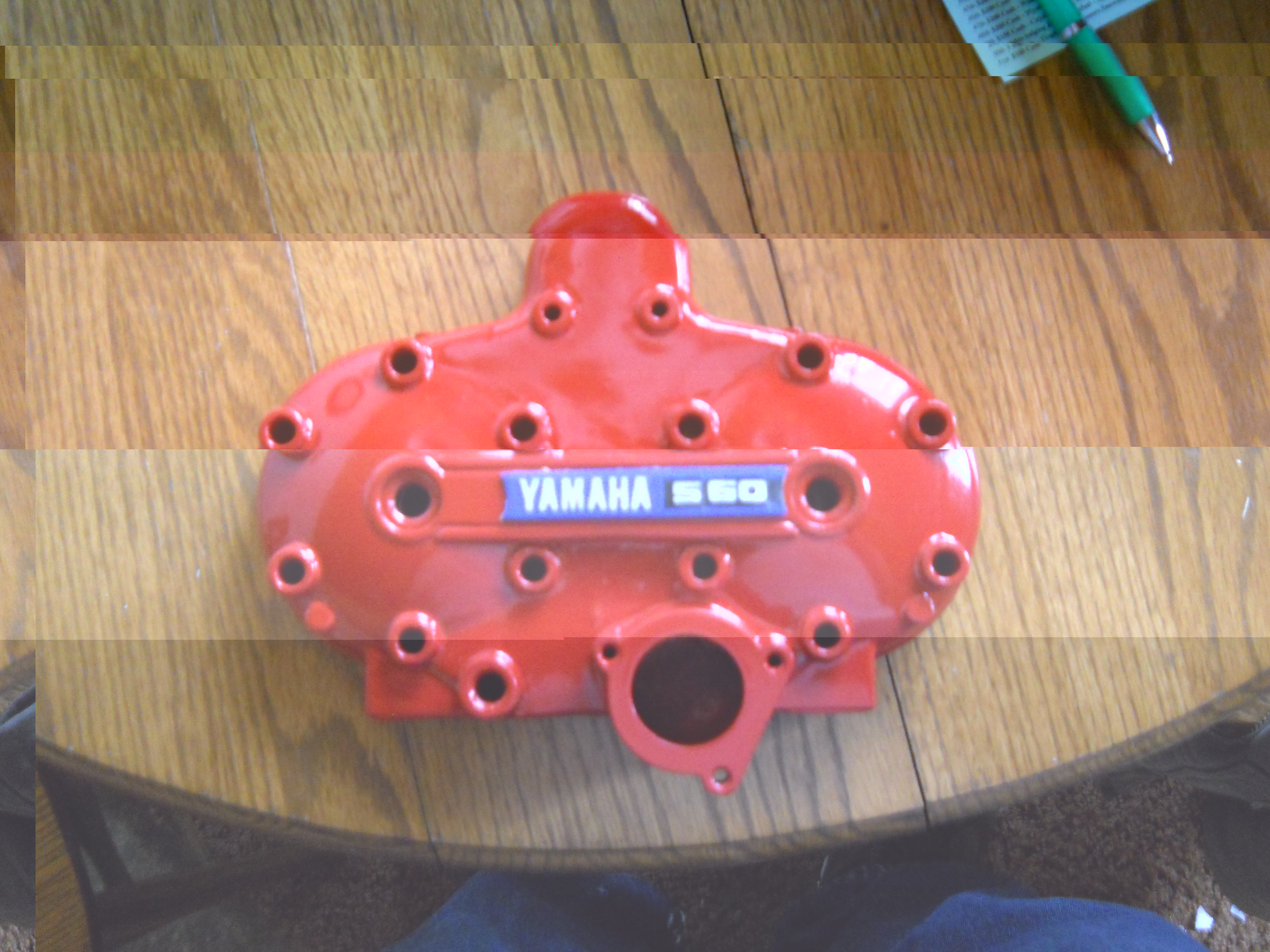

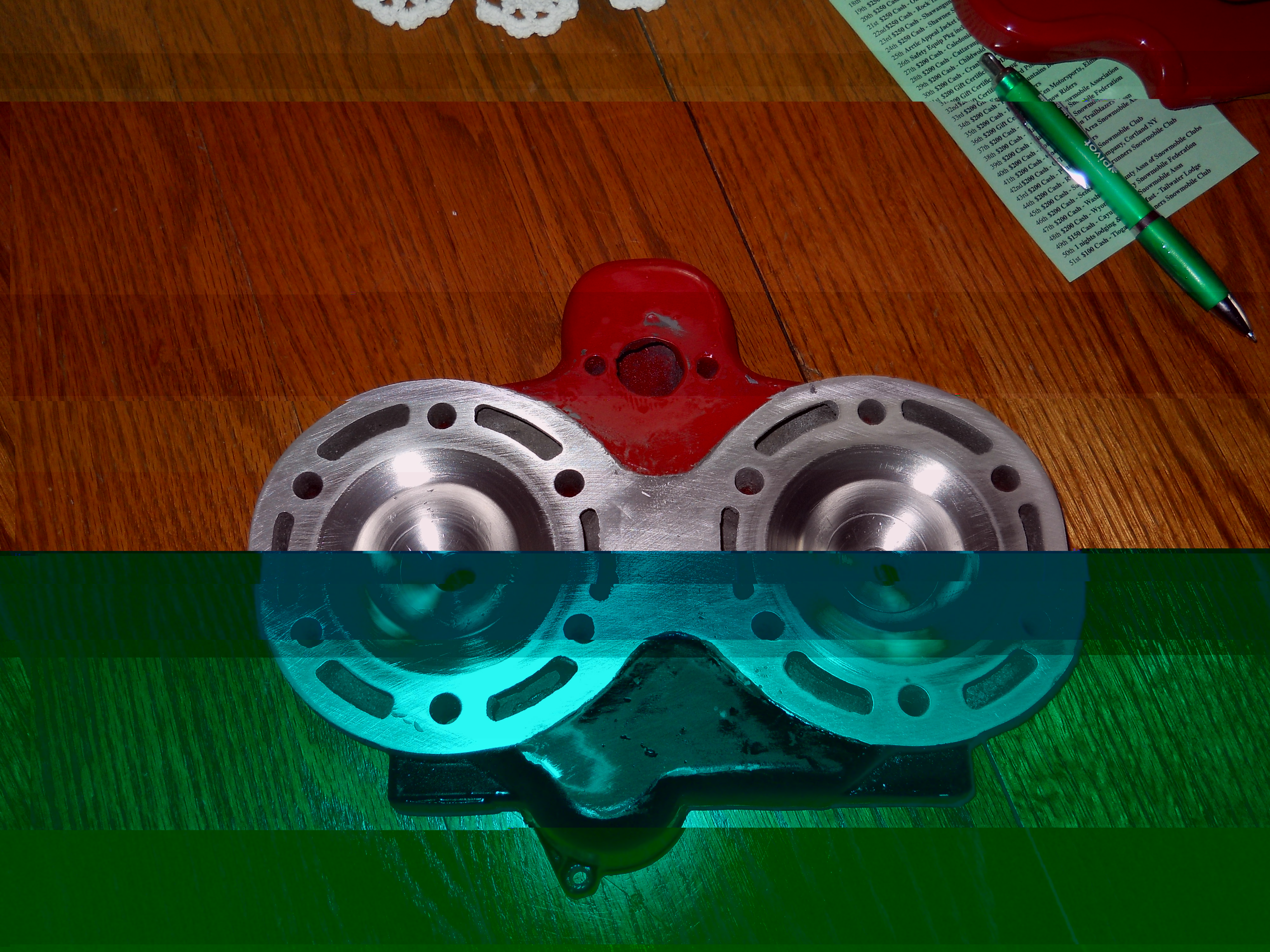

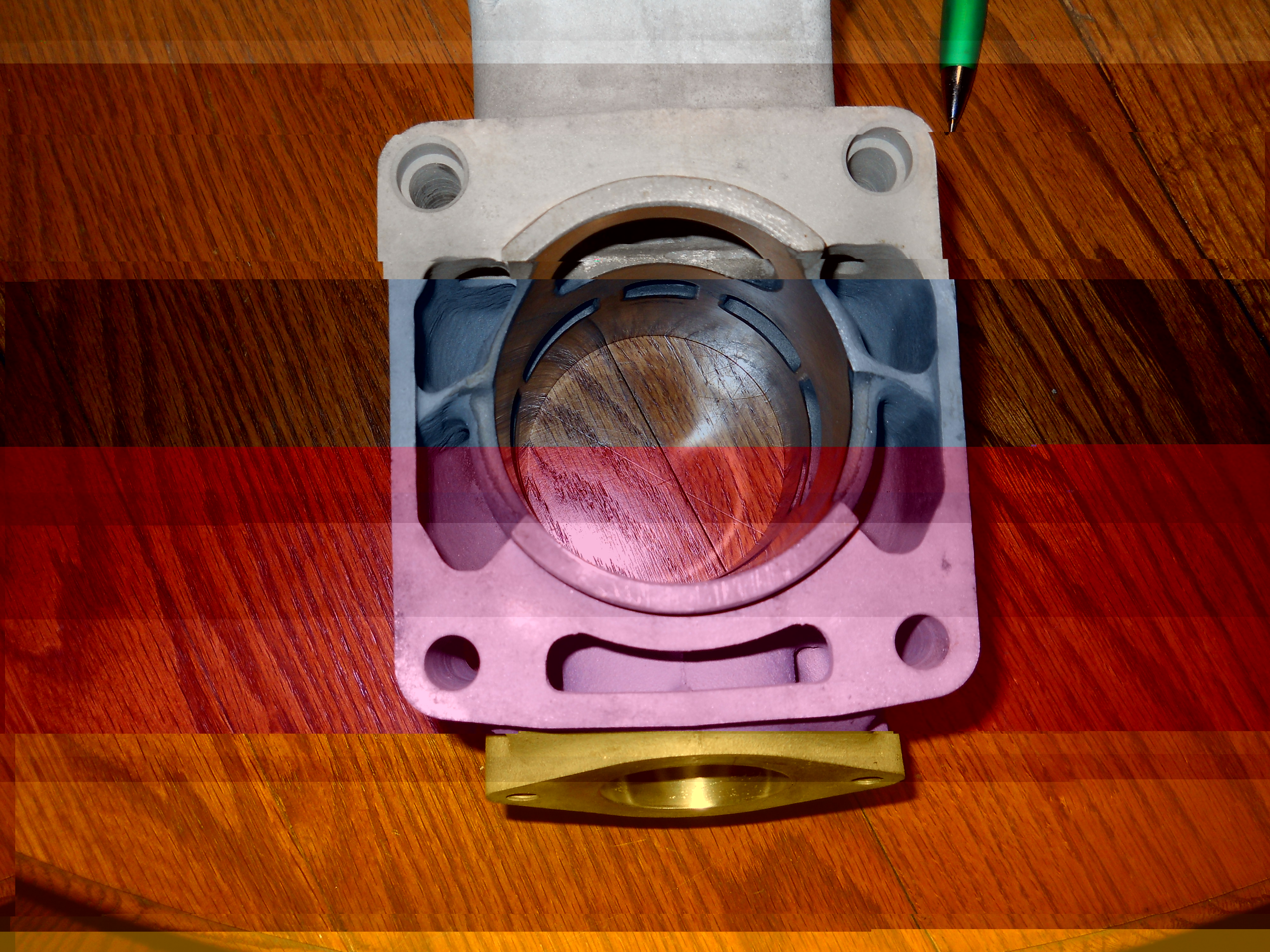

Just retired this past winter and I am able to find time to do somethings I have been wanting to do for a long time, this is one of them. I always wondered how the Vmax would run if it was a reed valve engine so I decided to build one and find out. I am using two cylinders from a 97 Vmax 600 along with pistons and the head. In order to make the cylinders fit I had to make a plate to raise the cylinders so the ports would not be partially blocked when the piston is at bottom dead center. I also had to cut the piston skirt so the piston would not hit the crank at bottom dead center. The bolt pattern had to be widened as well. The head was the trickiest part as I had to cut it in half and weld in a 25mm piece of aluminum to widen it to fit the cylinders as the 540 has a wider crank then the 600, also I had to weld in a piece of aluminum inside the head so the water would flow around and not just short circuit though the inside of the head that was widened. I plan on finding some 96 600 carbs to start with as well as add booster ports in the intake side of the cylinders. I still have a lot of work to do and figure out so I will continue to post the progress as I get it done.

Have had a little time lately to work on this. I have a little more machine work to do and then I should be ready for a trial assembly. Here are a few more pictures. Added some ports to the intake, polished the exhaust port and increased the boost hole in the piston. Had to widen the head 25mm, and also had to extend the divider inside the head so the coolant wouldn't short circuit though the head and not down the cylinders and up & out the other side. I will keep you posted as I go.
