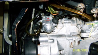

i just bought an 89 (i think) vmax. i am going to put the thing back together but am wondering if the clutches off of an 84 phazer will fit. i just have parts from my phazer that i am hopeing that i can use please let me know also i have been looking for the oil injection on the sled but cant find it im not sure if it has been taken off or not where is it located/ the oil resevior?

Give me the vin# and I can tell you the year of your sled. The secondary clutch off of an 84 phazer should work but, the primary offset would certainly be different ? The oil pump is on the back right hand side of the engines gear case assembly under neath the radiator and oil tank.sledheadkevin wrote:i just bought an 89 (i think) vmax. i am going to put the thing back together but am wondering if the clutches off of an 84 phazer will fit. i just have parts from my phazer that i am hopeing that i can use please let me know also i have been looking for the oil injection on the sled but cant find it im not sure if it has been taken off or not where is it located/ the oil resevior?

ok well ill work on getting the vin#. it looks as though the oil pump has been removed i see where it was. so what premix ratio should i run? i usually run a 50:1 in my two strokes or 40:1 what would be best?
