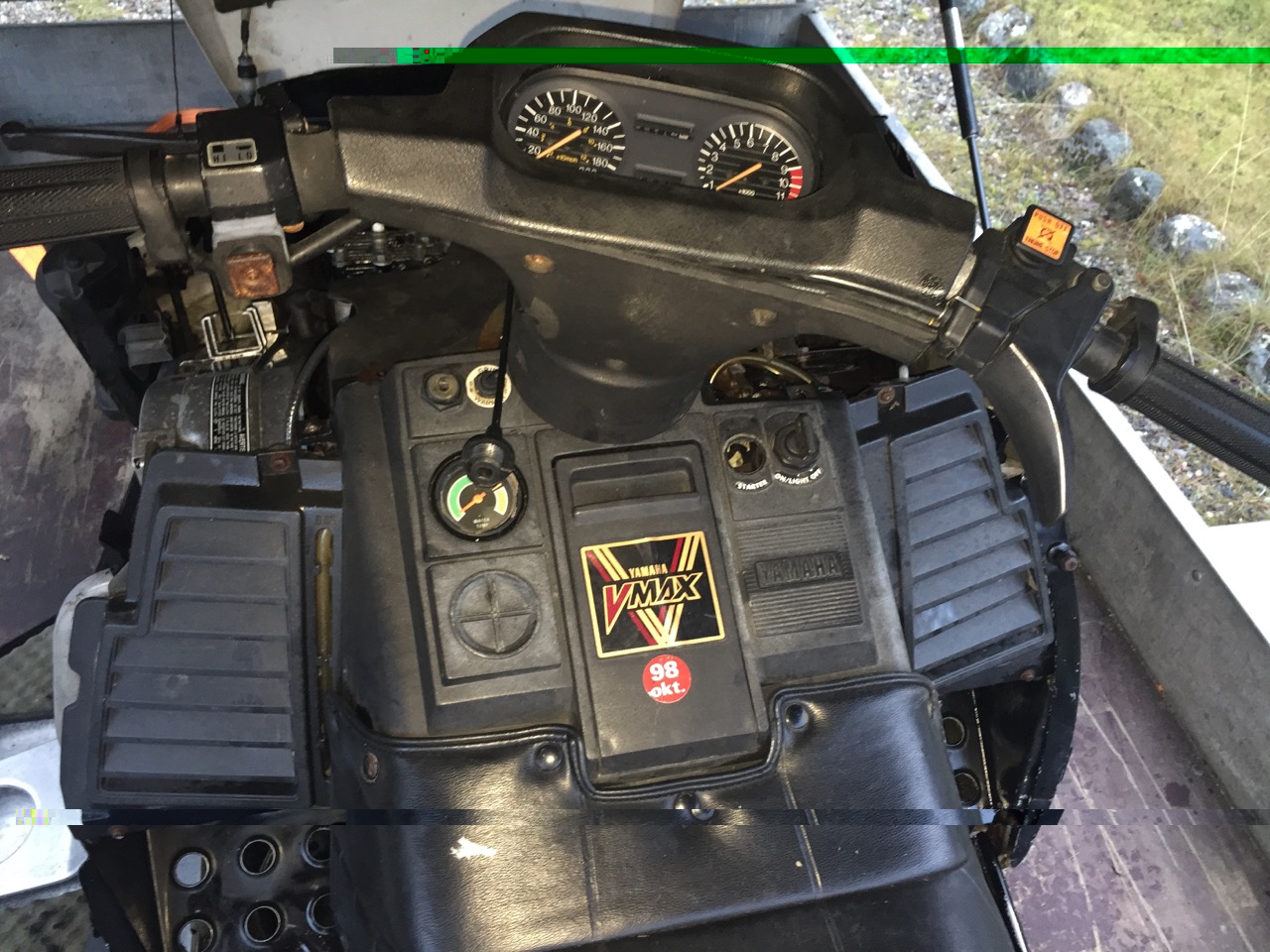

New member here and bought a 86 Vmax 540 just recently. The rust has got a bite on it, but seems like the frame is quite good.
Haven't got further than to cleaning yet, but it will need new boggie, track, engine rebuild and other refreshment.
Are the other pro action boggies the same width as the original for Vmax 540? Exciter, SRV, Vmax 500/600... Or is the Vmax 540 tunnel too narrow for those?

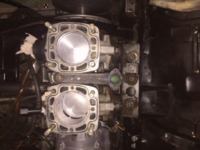

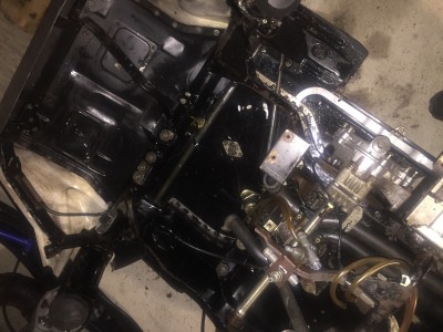

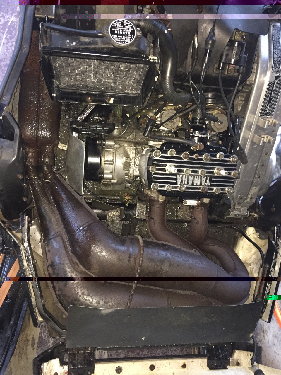

Measured the compression, was low on both. Chaincase side lowest at 50 and other side at 80.

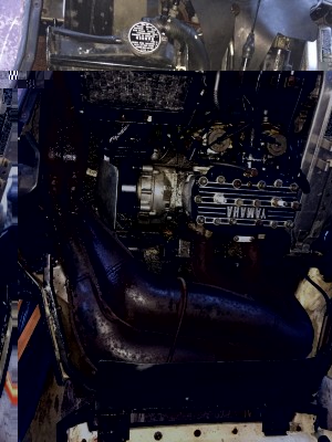

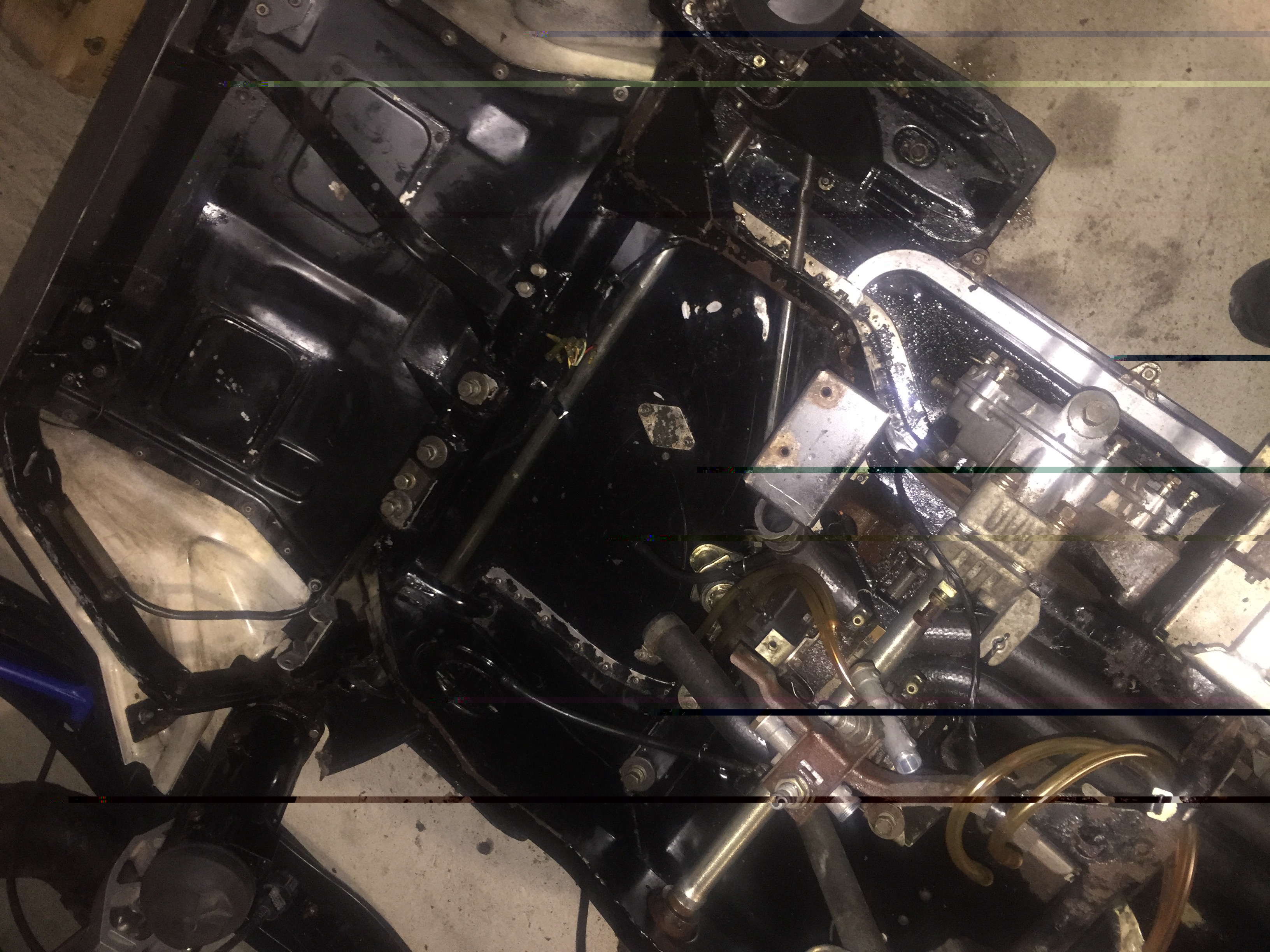

Removed carbs, airbox, seat, exhaust and drained coolant this weekend.
Next up will be clutches and lift engine out of frame.
What company are you Arnelo using for powdercoating?

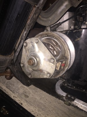

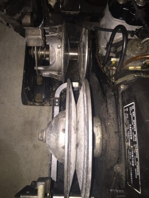

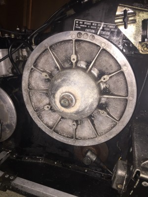

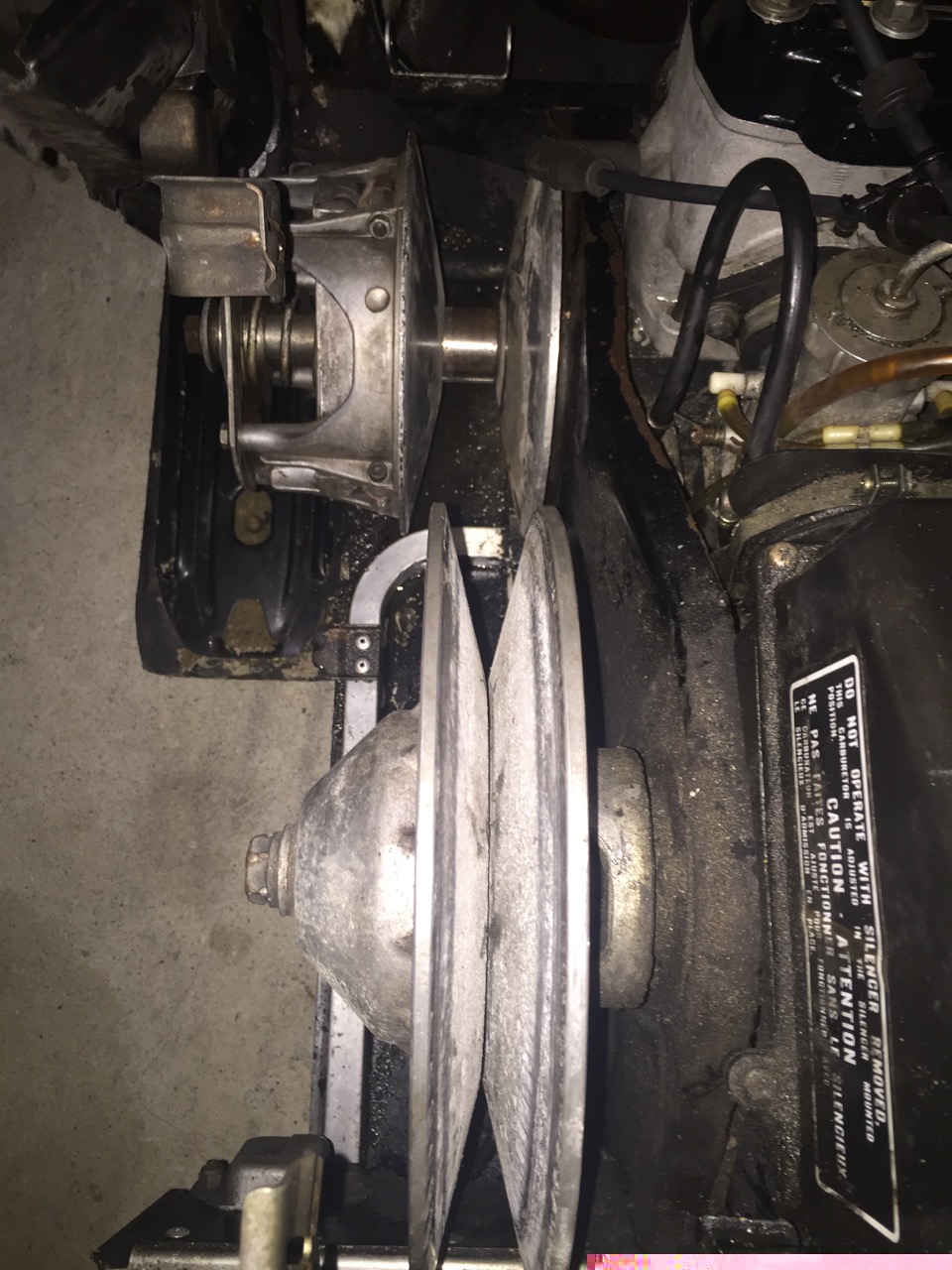

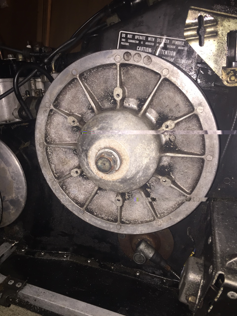

Hi Mathis. Looks like original clutch. Yamaha had comet primary clutch as default on this sleds. Around me, there is alot of companies that perform powdercoating. Are you member of norwegian facebook page snøscooter veteran og klassikere? Here you will find alot of other people with same interest.
Re: 86 Vmax Resto

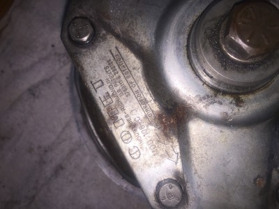

Looks like a 108c on the primary, originally came with a 102c the 108 is a replacement clutch. Great find non the less..
Re: 86 Vmax Resto
hmm, have to get those clutches off to see if there are any id stamps on it.

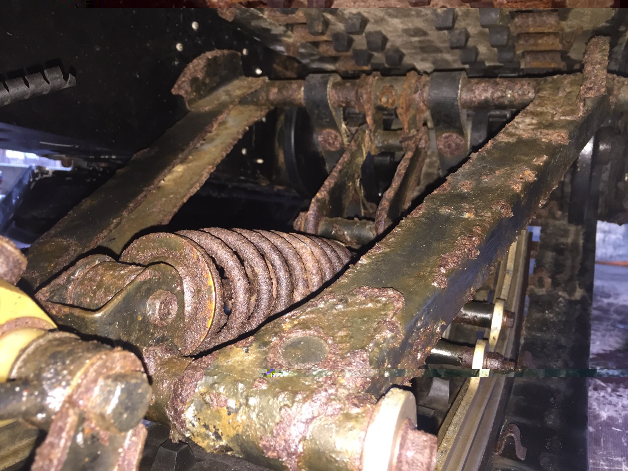

The T.S.S. are stuck, probably rusted. Haven't got to look more closely at those. But will need to rebuild the shocks if possible.
Or aren't there any parts available anymore?

Often its the knee action on the struts that freezes up. Sometime soaking and working the bolts will do it, often it takes heat. I have drilled out reamed them for a larger size bushing and started over but it solved the problem

This engine will need new crank bearings and new pistons. Anyone know of a good supplier for crank bearings? Some of the bearings are not available anymore, but must be some SKF/Koyo bearings that matches the original...?
Re: 86 Vmax Resto
Can't help with bearings but front and rear suspension components are shared with SRV's of the same vintage.
